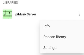

Once you've placed the files in the MinimServer content directory, did you instruct MinimServer to rescan for new and modified files? MinimServer doesn't monitor for new files as it prides itself on keeping resources low (and given moving files to your content directory is a manual process it's not too much to ask to also scan afterwards).
There are three ways of doing this:
i) Within BubbleUPnP, if you go to the section where you can select from your list of your music servers, and then select the vertical ellipsis next to the MinimServer library you'll be presented with the option to 'Rescan Library'
ii) If you're using MinimWatch on a desktop, right click on the MinimWatch icon and select the 'Rescan' option.
iii) Go to 'http://xxx.xxx.x.xx:9790/' (where xxx.xxx.x.xx is the ip of the MinimServer server) and click Rescan from the Status tab.
If you've already rescanned but the files still aren't showing in BubbleUPnP then there must be something wrong with your files and MinimServer is rejecting them.
If you're using MinimWatch to perform a rescan, right click on the MinimWatch icon, select 'Show log', then right click again on MinimWatch and select Rescan. If there any problems during indexing you'll see messages appear in the log window.
If you're not using MinimWatch then the log file can be found in the data folder of your MinimServer install named minimserver.log.
If there aren't any warning messages and your files still don't appear in BubbleUPnP can you send me a copy of one of the files, as MinimServer will definitely index files named XX.XX.flac as all my files are named that way.
This was my original response that still contains some useful information so I'll keep it here, even if it wasn't relevant to your response :)
